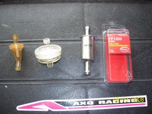

If the 4-out filter were mounted horizontally, and the body is not full of fuel, the outlet(s) on the top half may not have flow. Mounted vertically, this would not be a problem, but don't know if this is possible.
I have the one on the right in this pic, from AutoZone, 5/16" in and out, have had no problems. It's mounted horizontally above the carb rack.
That is the exact filter I had on the zl1000 before I installed the pingel petcock. Now i'm running no filter.
