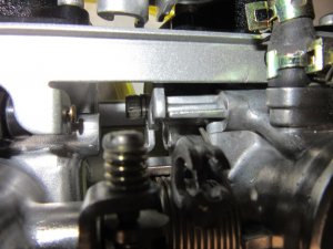

Is that a rail that holds the 4 carbs together or is that the choke slide.Is that a rail that holds the 4 carbs together or is that the choke slide.

ALEX : Do you have the part that broke off. Which carb is that. # 1 carb is on the left side of the bike as you are sitting on the bike. Here are pics of a set of carbs from a 1987 Kawasaki GPZ 1000. We can use them for a reference. I think the last pic is of the area that is the broken part on your carb.
That would be the #3 carb. The broken off part is where the choke plunger sets into. Also the throttle cables mounting stay bracket screws into it. Which is the back side. Most likely that would suck air into that cab. All of the 80s inline 4s use the same choke plunger. https://www.partzilla.com/product/kawasaki/16016-1061?ref=6a46bb584dbfd6ae8112b7a1f6961d0ecb9ec2f3 .
