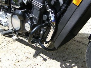

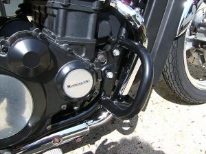

I bought a set of these 1 piece Engine Case Guards from Stedee-Enterprises for the zl1000. Thought I would share my experience.
These are made by one of our members GAZL900 and sold on eBay. The quality is top-notch with a nice satin black powder coat. They do require a little patience and alot of care when mounting as they are one piece and a snug fit. I had to buy new cap bolts from Lowe's 8x60x1.25 to replace the too short stock ones. The plastic radiator shroud will have to come off and I mounted 1 side at a time starting with the right side (easy side). Took about 1/2hr once I figured out how to mount them.
I have a 2 piece on my zl900 and they aren't as nice as these. Stedee-Enterprises plans on making another run of these so if you are interested post it up here. Maybe he will make up a chrome set too!

Do they look like the stock guards.I might be interested in some chrome ones.I have the stockers on mine but one side has a pretty good scrape in it.(I guess they did there job at some point)If the price was right I would replace them.

I bought mine with the idea that I was going to mount highway pegs on them. I have been rethinking that idea only because i don't want to scratch up the powdercoating on them. But it should work quite nicely.
