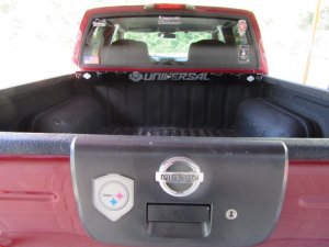

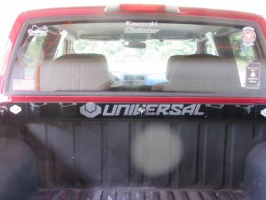

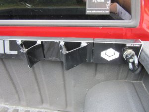

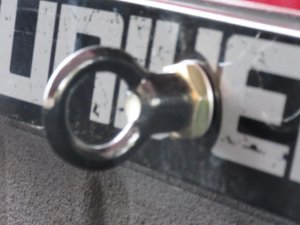

:hello: Guys I figured that I would share this with you all. This is a bed saver. It's manufactured by UNIVERSAL. I bought it from Rocky Mountain ATV/MC for $90 shipped. I just installed it on my Nissan Frontier. I also installed one years ago on my son's Toyota Tacoma. They are great for protecting the front side of a trucks bed, rear window & the rear of the cab. The nuts that come with it are self locking. I discarded them & welded up grade 8 nuts with a one inch stud which is also grade 8. This is for beds that have no room to tighten the nuts. I installed flat washers front & rear of the eye bolt along with a lock washer. I used an alignment tool to tighten down the eye hooks.

:hello: One other thing about this bed saver it has 2 mounting points & wheel chalks for either 2 motorcycles or one ATV. IMG_4602.JPG
