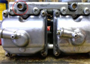

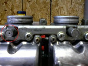

If they have never been adjusted, you will not see them - they are covered by little inserts (first pic) - drill a hole - carefully - put a hook or self tapping screw in them and pull them out. Then you will see the little brass screw (2nd pic). These are on the bottom, front of each carb. Later.
Thanks jarney. That was really helpful :thumbsup:
I'm so glad Blag was willing to ask that! It was a great mystery to me 'till couple of years back, had to look at someone elses bike to figure out why I didnt have any adjuster screws on mine!!
