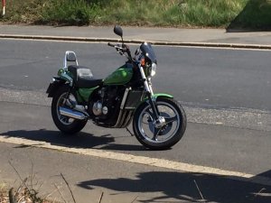

Just purchased this and have taken the Head and Cylinder off due to very low compression. It had severe carbon build up on the exhaust valves and ports,,, that is all cleaned up. I did have to purchase (off ebay) all new intake valves. The pistons, cylinder block and head (along with valves and springs) have been taken to a machinist here in Germany. He called today and said there are three pistons which are at the service limit and the cylinders are not round... enough to go back with STD sizes... I am in need of O/S pistons and rings.
Help... any ideas? I have been searching ebay sites in Europe for useable parts, new is my preference.
Does anyone know if pistons from a KAWASAKI ZX-6R 1995-1997 ZX600F 13001-1546 13002-1115 will fit ?
