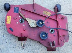

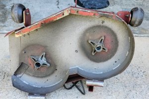

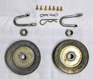

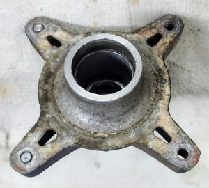

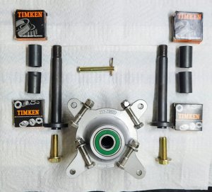

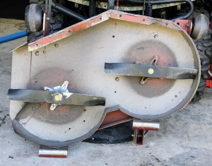

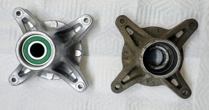

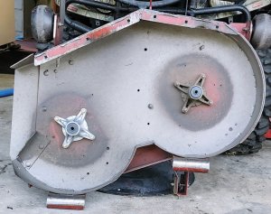

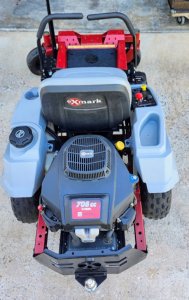

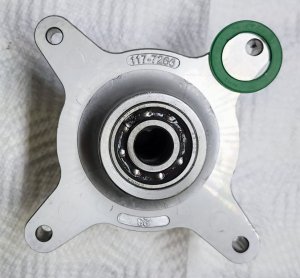

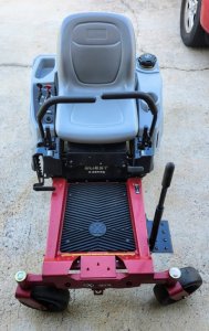

I've had my 34 inch eXmark mower for seven years. It has 330 hours on it. I change the oil every 50 hours. I use AMSOIL small engine SAE 10W30 oil. This past week I installed one new spindle and the another spindle I installed a set of new timken bearings. For the spindles mounting bolts I used stainless steel hardware. I also installed a new mower deck belt. The spindle shafts, blade bolts and the mover deck pulley covers bolts are also new. When I install new bearings I always remove one of the dust seals and add a bit more grease. Also I always use loctite on the blades bolts. I've had the blades bolts work loose and ruin the spindle shafts. ____________________________________________________________________
