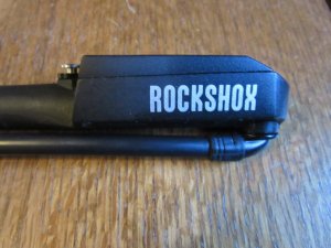

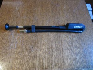

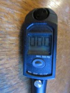

:hello: ROCKSHOX forks/shocks hand pump with built in digital gauge that I bought for $45. Max PSI is 300. I've had it for about 5 years. Price $70. It has a no air lost built in valve. When unscrewing it the air that you here is what is in the hose.___________________________IMG_8443.JPG IMG_8444.JPG IMG_8445.JPG Here is one with a dial gauge. Price $30. https://www.ebay.com/itm/High-Press...467118&hash=item3b33932929:g:6PMAAOSwMDpd~CDB . Here is one by FOX. Price $70. https://www.amazon.com/Fox-Racing-S...BZ24SYWXFG8&psc=1&refRID=8Q9VR8Y4ABZ24SYWXFG8
All good gauges and will do the job. Always use a hand pump on the front forks when adding air!

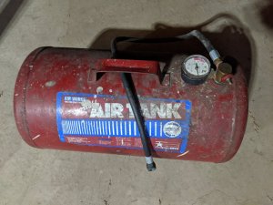

My trusty fork pump, lol. I bleed it down to 10-15 and hit both legs.IMG_20200126_100844.jpg
