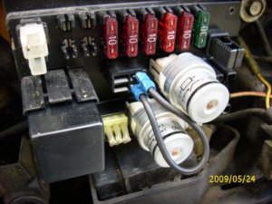

It gives a little trick to check the lights without running engine: You must connect the both contacts on the right side of the socket from light-relay, then you can switch on the light only with ignition-on without running motor.

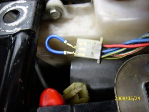

The next one is, you can disconnect the reserve-switch an connect the blue wire with the blue-yellow one. You don't need the reserve switch now an can check the rest of wires an switches.
Give a look to the right diameters for the wire-bridges!!!
Kind regards, Alex

alex-germany....if i set it up that way,can i run the bike to see if it might be the reserve switch or relay?
alex-germany i reread and understand now, sorry.
What about bypassing the fuse pannel, has anyone done this?
I'm fed up with this silly problem
If i understand you right,then you want to drive the bike with the wire-bridges and without relay and reserve-switch? Is it right? I see there no problem to do this... I would to do this.
