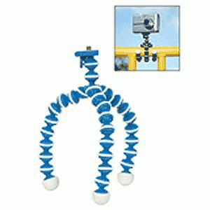

I have 2 different camera mounts. First one i got kept moving in the wind so I bought a cheapo "flexipod" mount , i think I got it in some wal mart some place. It is a tripod but the legs wrap around the handlebars... it does not move at all.
The next thing i found out is that video clips taken from the handlebars of a moving motorcycle get pretty boring to watch after a while!! I have quite a few.... Most interesting shots are actually when you are riding with your mates and they goof off knowing they are being filmed!! Driving through valleys and mountain scenes just dont really do justice with a digi cam. I spose if you had an expensive HiDef camera it might be a bit better...? Depends what you're into I guess...
I find it's just as well to have a point and click digi camera in a tank bag ready to grab and shoot...
I have a gps ram mount for my garmin nuvi. It is very good quality plastic and fittings. It does not move and is very well made. I'm sure you'll be very pleased with your camera mount Mick.
Edit... Heres a pic of the flexipod mount I use most of the time.

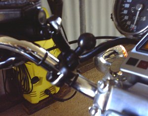

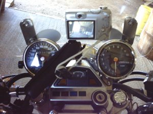

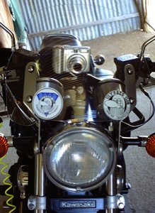

Well, I got the RAM Mount bits and pieces for the motorcycle camera mount last week, after some delay (the Aust Post "Express Post" parcel (min 2 days delivery) got "lost" in transit for a couple of days!!!, jeez, they can't even look after one their own workers !!!) and fitted it all on the handlebars and it's great, couldn't be easier to fit and very position adjustable and rock solid.
I bought;
1 x Handlebar mount
1 x 5.25" Arm
1 x 3.0" Arm
1 x Camera Stud Base - 1/4" Ball Mount
1 x 90° Mirror Mount (11mm hole)
1 x 45° Handlebar Mount (9mm Hole)
1 x 1.5" Double Ball Adapter
I can leave the handlebar base mount permanently attached to the bike and add the various extention bars and device mounts as required.
Attached is a couple of images to show you all what it looks like fitted up;

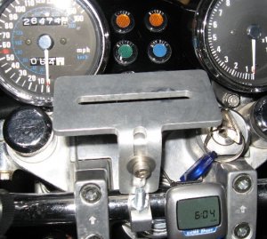

I like having the camera handy as well but I usually have the camcorder mounted to the front when riding with friends or going somewhere unusual and the camera in a pocket. The mount pictured below is what I use for the camcorder. I just slip remote control for the camcorder into an outside pocket, flip open the LCD screen and run everything from the remote. When not in use I remove the top plate and leave it at home. I like that it's very stable and can be adapted for GPS, radar detector, etc. But it's not exactly sleek looking. I think I spent about $40 for it.
Stormy, let us know how stable that RAM mount is, I might look into it. One thing I will add for taking videos, use a remote mic into the helmet or jacket if you don't plan on dubbing music or something into the video. Wind noise is overwhelming at anything over about 50MPH. A fairing or screen would help as long as the camera doea not try and focus on the screen itself.

I took a video using the mount whilst on our clubs annual "toy run", it worked a treat, pretty stable even up to 120 kph, I can even switch the camera off and on play with the menu and use the zoom functions whilst riding, the video is way too large to upload on here, like about 34mB, but it lasts about 10 minutes, it includes footage of the street parade of about 120 bikes and trikes and road riding footage of some of the poker run.
A few riders on the run commented on it after seeing the camera mounted behind the windscreen, so I think RAM mount is going to get a little extra business soon.
