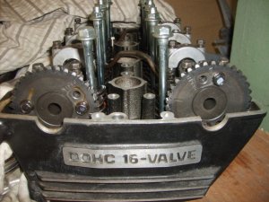

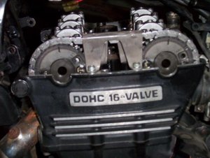

By the way here is a pic of the early 900 cam gear and one of the properly installed newer 4 bolt cam gears
