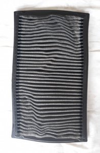

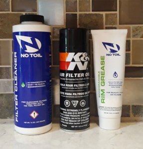

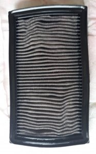

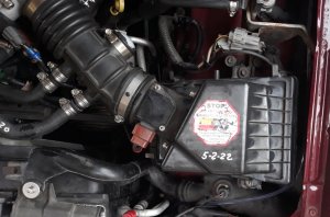

:hello: For the past 25 years I've been using NOTOIL air cleaning products and K&N air filter spray on oils. The notoil filter cleaner is a white powder. It takes 4 to 6 OZs to about a gallon of water to clean a car/truck filter. Much less to do a motorcycle/ATV/mower air filter. This is the best product that I've found when it comes to cleaning filters. Iv'e used it to take grease/oil stains out of white shirts. https://www.revzilla.com/dirt-bike/...e9oIFHi9ius0k2UHVxgRyv6KT_uQ4eXMaAl6BEALw_wcB. https://www.amazon.com/Air-Filter-C...locphy=9011757&hvtargid=pla-505177672557&th=1 . ________________________________________________________________________________20220503_095042[1].jpg 20220503_093312[1].jpg 20220503_101217[1].jpg 20220503_101633[1].jpg 20220503_102414[1].jpg
