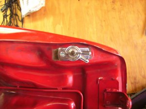

I can position it any way I want to depending upon how much I tighten the hex valve. It is set up pointing to the right side as of now.

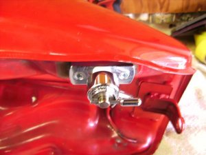

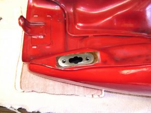

Budkaw900 came over today for some help with the pingel install and tank venting issues. I use a air hose regulated at 20psi to help blow out the filings as I open the hole(pic1). Then I test fit the pingel with 4 wraps of teflon tape to the adapter plate to see which way the adapter plate gets installed. Mark the adapter plate for orientation. On the ZL1000 you need to remove the petcock from the adapter plate remove the teflon tape and apply 4 wraps of new teflon tape. Install the adapter only with the correct orientation that was marked earlier and torque to 8-10 ft lbs. Then install the pingel into the adapter plate. On the zl1000 the outlet of the petcock will cover the rear adapter plate bolt when it's lined up correctly. On the ZL900 the petcock handle in the "on" position will cover the rear adapter plate bolt. This will give you clearance between the handle and the valve cover when in the "off" position.
It's been my experience that when you properly torque the adapter plate the pingel gasket gets squished too flat and will leak. I use felpro rubber gasket material to make my own gasket. It's a lot stronger than the pingel gasket. I also use the included hylo-mar gasket sealer on the adapter plate bolt threads.
