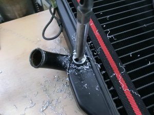

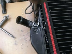

1. Drilling out for M14 (Ø 12,5 mm):

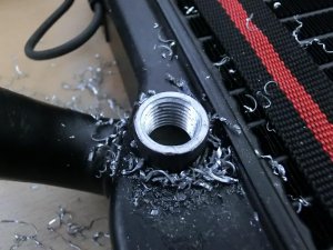

2. Thread cutting M14x1.5:
3. Ready for switch:

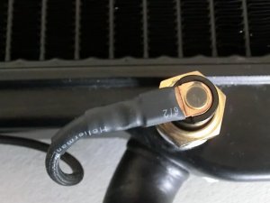

5. Built-in:
6. Shrinking tube to prevent premature corrosion on contact surface:

5. Built-in:
