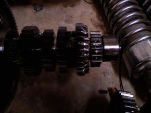

Tim, You have done the trans already? What were the symptoms and what did you replace?
My middle shift fork broke in half. Caused the gears to mesh half way. The rear tire locked up and came to a halt. Trans gears were trashed. I always had the problem with fifth gear popping out. The sad thing but good thing is it broke going easy into second. Earlier that day I was riding about 120 on a straight away. So if you have shifting issues I would go ahead and tear it down and replace shift forks and, check gears. The guy I bought the zl from bought a set of trans gears on e-bay just beacause they are rare, so he gave them to me with the bike.
