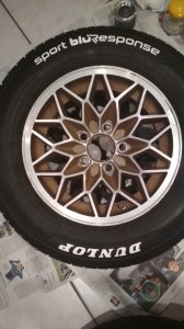

The tyres are Dunlop Blue Sport Response in 215/70R15 with a good wet grip. But it was a lot of work, to paint the letters white with little brushes.:confused:
But i wanted good tyres for my money. And sorry, the american RWL tyres aren't the best choise for savety drive! :D

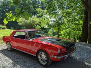

Nice, we do have some good all season radials in the 15" size. I have BF Goodrich radial TA there is no Michelin sport cup rubber to fit this rim, nor would I want it on there. My 66 mustang has been upgraded over the years and like you, I built it to be a driver.IMG_20220725_110146.jpg

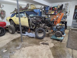

I know it is supposed to be a build thread, it sure doesn't feel that way right now. She puked a bunch of coolant and you cant help but get some trans fluid stains. 20260307_120352.jpg 20260307_132915.jpg
My old trusty dolly gave up the ghost, the board rotted and wheel collapsed. Bummer, had that for a long time.20260307_120343.jpg
:hello: Frame looks solid. Seems like it spent less time on PA Winter salted roads than most. What make are the wheels on your Mustang.
20260308_114249.jpg 20260308_113623.jpg They are centerline wheels.

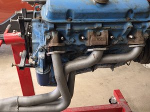

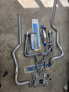

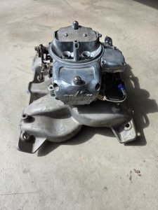

Im at a crossroads. I have an edge edlebrock p4b intake and swap meet headers (3 tube variety), some gently used flow master mufflers, new cats if I want to keep the stink down, new 2 1/2" tailpipes, an older Demon dual feed 650 carb. All I really need is an X or H mid pipe to complete the exhaust. Do I throw all that stuff on or keep the iron intake/exhaust manifolds and just dual exhaust it?
Manifold won't net me any performance gains and carb may be a wash too

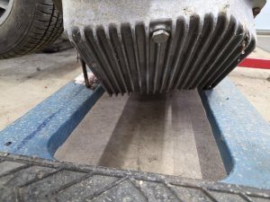

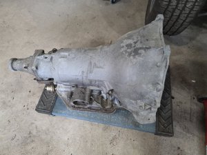

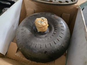

My buddy gave me his th350/stall converter a long time ago when he did his 5 speed swap to his 68' bird. How long you ask, I paid another transmission guy i drank with $350 to do a freshen up on it, try to find someone to even look at one today for that money. It came with a nice finned aluminum pan.
After a bit of research, the headers appear to be Blackjack.
Hell yes! Can't do any better than $350 that's one good friend!

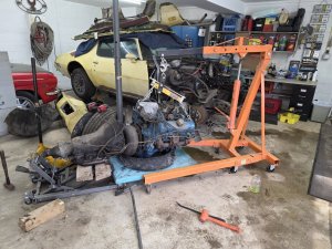

4 big bolts left. It looks heavy o_O I may have to ask a friend to bring a jack or 2 and lend a hand.

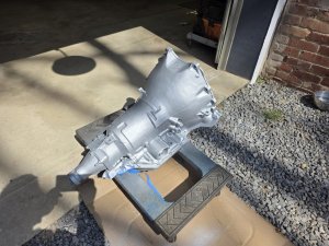

The old days of having pontiac engine paint on the shelf at the parts store appear to be gone. Paint on the trans yesterday.
Time I guess to take the manifolds off the engine.

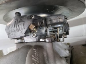

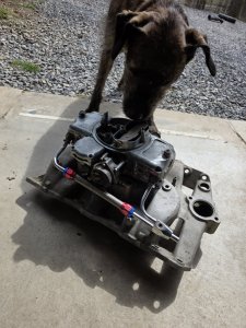

Looks like there is header clearance for the oil filter. I also dug out an old swap meet Street Demon dual feed with an electric choke since swapping to the Edlebrock doesn't allow for the stove pipe choke and it's ~$100 to convert to electric i would rather deal with the holly style. I even had a junko dual feed line in my hoard.20260329_130443.jpg 20260329_144137.jpg
Dog approved

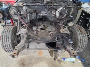

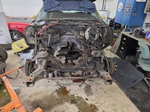

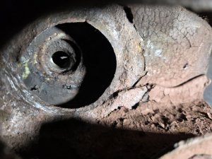

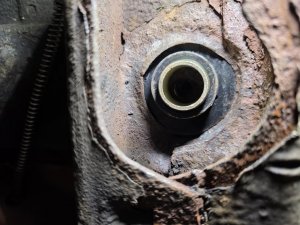

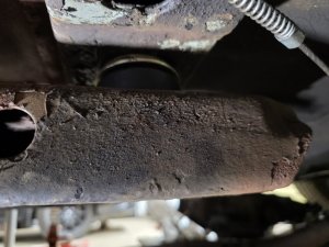

The reason for the carnage of the front end being off: Rear driver body mount has a big 2 1/4" hole (off center too) where there are supposed to be small 1 1/2" hole. Probably all 4 will need some love. Common issue, rubber bushings invite water, frame goes away.20260331_173039.jpg 20260331_173103.jpg 20260331_173239.jpg
Genuine mileage, not rolled over.

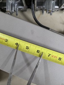

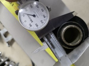

So, I placed the upper bushing in and tossed the bolt to properly position it. Then I scratched the perimeter of the new bushing with a pick. As a backup position marker I will make a cardboard template using a cereal box with a centering hole in it to fit the bolt and trace the outside of the frame in it. I need to get these locations accurate before I drop the frame.
No, I'm going to hit it with a wire brush, prime and paint it chassis black. Im not planning on replacing suspension parts till I get some miles on it and it needs it. I'll inspect it before it gets thrown back together. Budget build, solid driver is what I am after.
