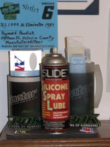

:hello: To prevent rust you can spray down all medel parts with a dry lubricant such as Remington Dry lube or Slide. Also WD 40 makes a Silicone spray in a can.
:hello: Instead of using wood to store the bike on use a rubber mat or thick carpet. This will prevent flat spots on the tires as while as preventing dry rot.
