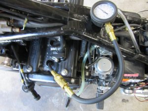

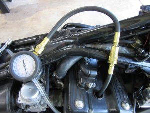

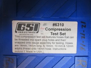

:hello: I couldn't find a thread on doing a compression test on the ZLs so I decided to do one. Here is instructions/procedure on how to go about performing a compression test. This applies to any gasoline combustible motor. IMG_4423.JPG

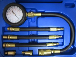

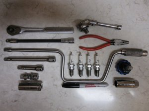

IMG_4435.JPG :hello: Here are pics of tools that may or may not be needed but any good tool is a great tool that makes a job easier. I number the spark plugs using a black sharpie. IMG_4434.JPG IMG_4424.JPG IMG_4429.JPG IMG_4431.JPG It is best to use a 18 mm 6 point deep well spark plug socket. You can always cut a piece of rubber hose & insert it into a regular 18 mm deep well socket.

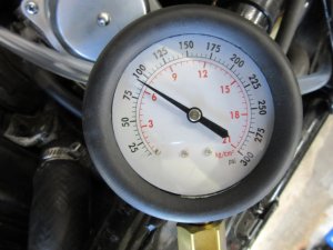

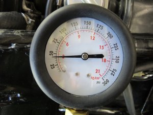

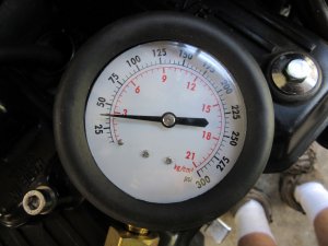

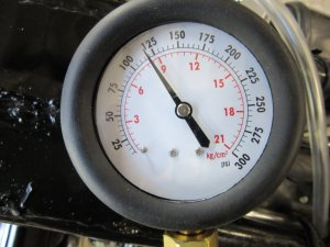

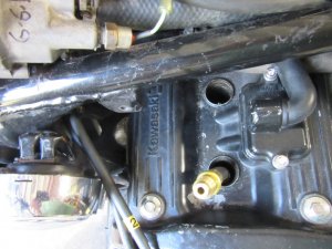

:hello: While I just got done doing a Compression Test on Ron D. ZL 10. See pics for results. Cyn 1 threw 4 was done in order as the pics was taken. I wonder if I'm going to be blamed for this to. :laughing7:. It was fine 2 weeks ago. IMG_4438.JPG IMG_4439.JPG IMG_4440.JPG IMG_4441.JPG IMG_4442.JPG IMG_4444.JPG IMG_4443.JPG
Maybe time to adjust the valves on that one.
:hello: It is way past the time for the valves to be adjusted like 4 years ago. The bike was getting really bad gas mileage from the first day Ron owned it. I told him at least 10 times that he shouldn't ride it until the valves get adjusted. It has over 24 K miles & most likely the valves have never been done & the carbs was never done. Cylinders two & three are so low on compression that the motor may need a valve job. I know when I call him he is going to blame it on me. It was fine 2 weeks ago. I must of heard that a dozen times. At this point I don't even care if I get paid for all the other work that I have done. I'm not bad mouthing him either just pointing out the facts.
:hello: I learned a lot on this bike. You always do when you're pulling out your hair. I sort of wish it didn't happen like it did or I would of thought of checking the compression earlier. The bike acted like the problem was an electrical issue but when each time I'd start it after changing a part or what ever the problem of staying running would get shorter. I never ran it for all that long maybe a minute or two. I never test rode it for fear of messing something up. So the last time it was started it ran for only 20 seconds or so. Then it would not start at all but I did not lay on the starter button much. Again I did not want to screw something up. I said to myself self it fired right up when I put the carbs on the last time & idled smooth as silk. So I called my friend Ron A. & explained to him what was going on. He said the valves are really tight & that I should do a compression test. I did tell him that the bike was only getting around 20 MPG since Ron D. first bought it almost 4 years ago. Tomorrow I'm taking the bike to our friend Jeff. I just don't have any more time to spend on this bike. Iv'e had it for 7 weeks. Half of that time was waiting on parts & half of that was trouble-shooting.

:hello: While I talked with Jeff & he did a compression test on Ron D. ZL 1000. All 4 cyn came back with 80 to 110 PSI. He did the test with the carbs off the bike. He said that way the cyns get more air. I'm not really sure if that matters. He said that he will not adjust the valves. :banghead:. I thought that a bike should have 125 PSI or greater.
:hello: I think time's up to adjust the valves on that bike, next repairs will be 'more heavy'...:laughing7:
