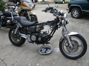

it is in good hands :headbang:
Thanks Chris, I don't have any pics to post up, but who wants to post a pic of their non running bike? End result though will be a rebuilt engine by some of our gurus from the ZL world. Mark asked me if I wanted a 10 or 11 second bike and I told him that I am not commiting with a statement of do what you need to do. Hell, I might have to mortgage the house if I agreed to that.
