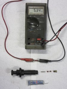

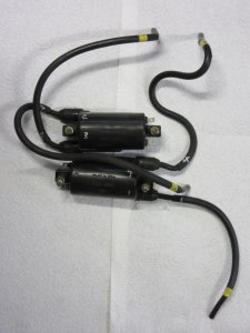

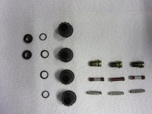

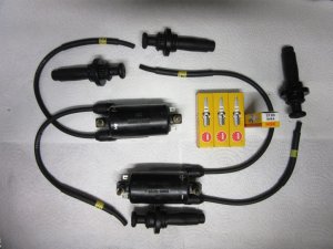

:hello: Since my tank was off for hose replacements I removed the coils, wires & plugs. I installed new plugs & wires. I took apart the spark plug caps for cleaning. Checked the 5 K ohm resistors. Inspected the springs & put a dab of dielectric grease on the parts & reassembled them. I had 7 spark plug caps given to me. 2 new ones & 5 used ones. Only 2 of the used ones was not dry rotted. I stripped the bad ones of all the internal components & tested the resistors for 5 K ohms. They all ranged form 4.8 to 5.3 K ohms. The insert that holds the spring & resistor can also be removed for inspection of cracks & corrosion. It is a good idea to clean the inside of this insert/retainer because carbon deposits & other foreign matter can find its way into it & restrict current flow. Sometimes after reassembling a spark plug cap you can get a open reading on your meter because of foreign matter that makes its way into the insert. The insert is the ceramic/plastic part that houses the 5 K ohm resistor & it's components. After reassembling a spark plug cap recheck it for 5 K ohms. This test applies to the ZL 900 & ZL 1000. When using old spark plug wires cut about a 1/4 inch from each end. It is best to go ahead & replace the wires with new 7 MM copper core wire.

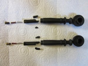

:hello: A few weeks ago my one friend Bob's ZL 1000 motor was intermittent on cyns 3 & 4. Trouble-shooting lead to the finding of the plastic/ceramic inserts on those to cyns spark plug caps was cracked causing the problem. I gave him two good usable spark plug caps. First we dissembled them. I cleaned the inside of both ends of the cap with a mixture of baking soda & distilled white vinegar. Use 2 table spoons of baking soda to one cup of vinegar. Next I sprayed both ends of the stripped caps plastic inserts that house the spring, 5K ohm resister & brass spark plug retainer gizmo while it was still inside the outside insulator with carb cleaner. Then I used air to dry the insides. Sometimes foreign matter can find it's way inside causing restriction. Then I cleaned up the brass threaded gizmo on my grinders brass wire wheel. Next I put dielectric grease on the other parts & resembled the spark plug caps. Then tested for 5 K ohms of resistance. I also gave him new spark plug wires. Here is a pic of the broken caps.

:hello: After reassembling the caps with spark plug wires check again for 5 K ohms. Post # 1 pic # 1 I have the one coil facing the wrong way. I numbered each spark plug wire to it's associated coil with a silver sharpie before taking them apart.

:hello: In pic one of post one the reason one coil is backwards is form the P O. He shortened the plug wires to much so instead of spending a few dollars on new wires he reversed the one coil. I can buy copper core 7mm spark plug wire @ 0.58 cents a foot from our local old school auto parts/machine shop.
