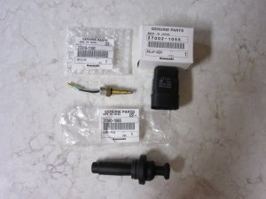

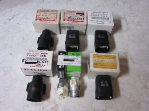

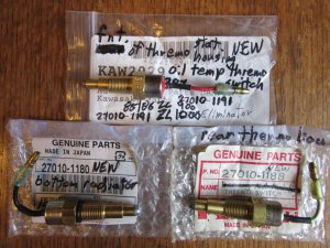

    :hello: Guys I got my NOS OEM cooling system relays & thremo switches in the mail today that I bought on E-bay. OEM Part # 27002-1055 large relay. OEM Part # 27002-1054 small relay. Both are located under right side of fuel tank. The box far right in the pic OEM Part # 27002-1052 is for another KAW. It comes with 3 relays molded in one rubber sleeve/hood. They have the same maker/manufacturer part # as part # 27002-1054. You get 3 for the price of one. I used a butter knife to remove the hoods to verify that they are the same. Oil pressure switch OEM Part # 27010-1313. Under right side of motor on the oil pan. OEM Part # 27002-1191 oil temp thermo switch. Front of thermo-stat housing which has red/white wire lead. OEM Part # 27010-1188 warning thermo switch. Rear of thermo-stat housing which has white/green wire lead. I'm still waiting on OEM Part # 27002-1180 thermo fan switch. Bottom rear of radiator with black wire lead. IMG_7166.JPG

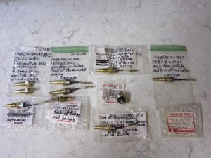

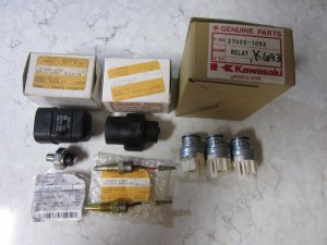

    :hello: I got my last 3 OEM NOS parts from that same seller said above. I didn't know that I ordered 2 of the large relays OEM part # 27002-1055. Shipped for $42 each. Thermo fan switch OEM part # 27010-1180. Shipped for $44. Spark plug cap OEM part # 21160-1065. Shipped for $32. Small relay OEM part # 27002-1054. Shipped for $44. Warning thermo switch OEM part # 27010-1188. Shipped for $28. Oil temp thermo switch OEM part # 27010-1191. Shipped for. $34. Oil pressure switch OEM part # 27010-1313. Shipped for $46. Non ZL 900/1000 Kawasaaki small relays 3 each no hoods. OEM part #27002-1052. Shipped for $48. This set of 3 are the same as OEM part # 27002-1054. IMG_7179.JPG
