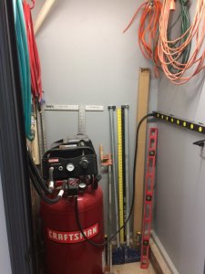

    :hello: Nice. :notworthy:. Did you install any kind of air filtering system along with a water catch bottle.

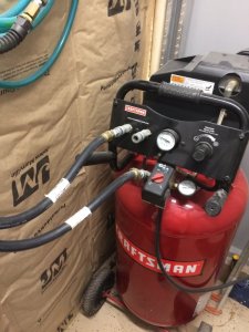

    RJ. No I haven't put any filtering on it. I do have a drain on the bottom for draining the tank. Honestly I do not use air for much. I have switched over to battery impacts and ratchets. The majority of my air usage is a brad nailer, airing tires and blowing off dust. When not in use it can go months without dropping any pressure. I put two bulkhead fittings in and those attach to the compressor thru 36" hoses on the inside of the room to the full air out and the regulated air out. They have quick couplers so if I need to move it out I just disconnect the two lines, unplug and roll. It's a 33 gal oiless compressor. If my air needs were more significant I would have a completely different set up.

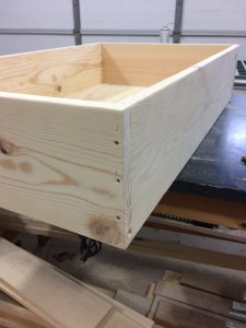

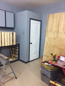

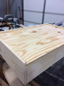

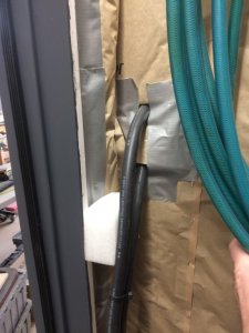

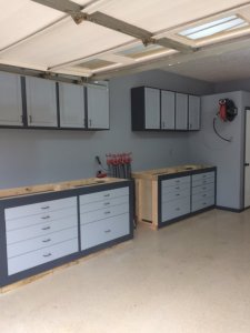

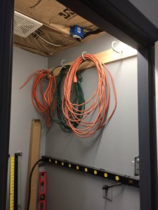

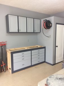

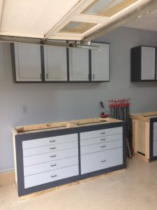

    image.jpeg image.jpeg image.jpeg image.jpeg image.jpeg image.jpeg image.jpeg image.jpeg image.jpeg image.jpeg UPDATE:

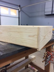

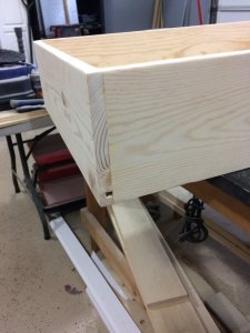

    Well I ran into problems with fitment of my initial 20 drawers I built. The problem was basically with the framing of the left side workbench. I got that straightened out. There were inconsistencies in the framing just because it's rough 2x4 material. So I built 4 insert boxes that were perfect and identical. I placed the drawer slides in them before putting them into the frames. I changed the drawer configuration and went with 18 instead of the original 20. A good friend of mine recommended using UV coated birch plywood as a material since he himself uses it a lot. The UV coating is basically a very heavy clear finish. Plywood is a good material because it's very consistent in its thickness and it won't easily warp, cup or twist like the original 1x material I used the first time. I decided to use locking rabbit joints on the drawer fronts and backs.

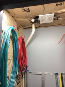

    The compressor room is basically done. I used two bulkhead fittings on the wall. I can swap the hose reel supply from one to the other. One is regulated air and the other is full pressure. If I want to move the compressor out I just unhook and roll out. Outlet strip on the one wall will get all my battery chargers plugged into it. I have to build a shelf for all the chargers. I decided to put a vent fan in the top and an additional open pipe to allow flow. I put an LED light in top and a switch for the light and the fan. It all worked out very well. I started working on the center portion for my miter saw. Compartment below will house a shop vac for dust collection.
