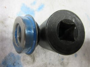

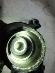

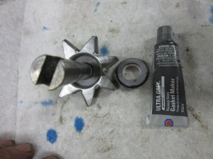

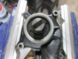

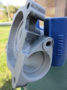

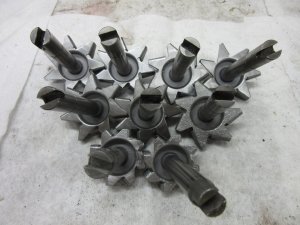

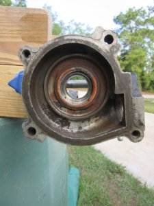

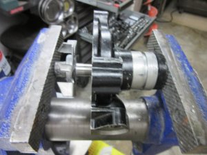

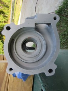

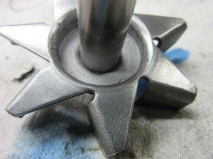

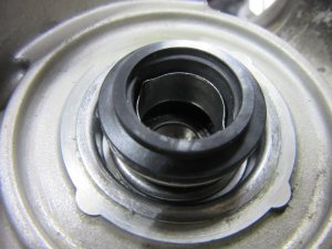

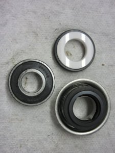

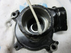

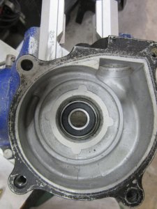

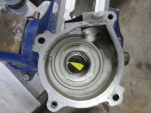

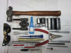

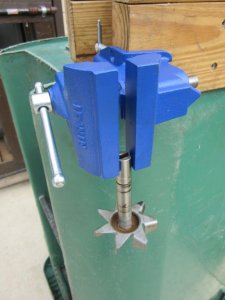

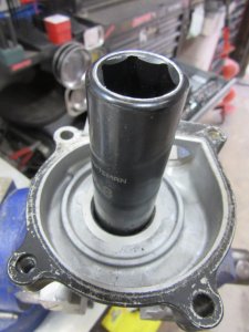

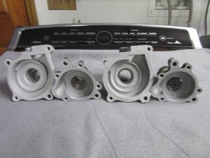

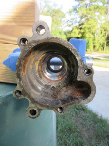

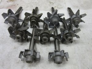

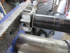

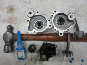

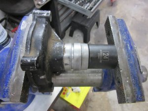

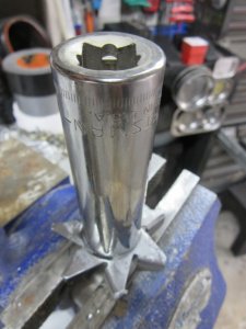

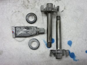

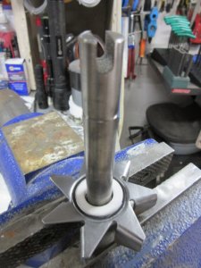

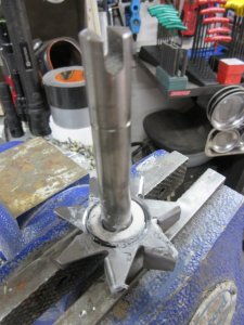

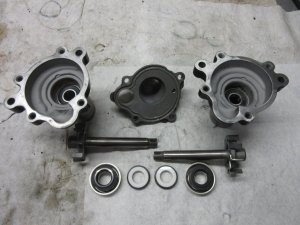

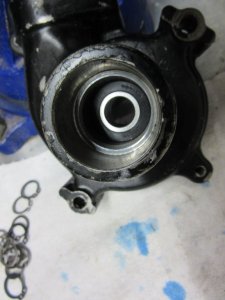

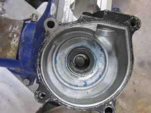

:hello: I sand blasted all 9 water pump propellers and shafts then polished all the shafts. Then installed the ceramic disk onto all 9 shafts and seated them into the propellers. Next I installed the inside bearing in all 9 pumps. For 5 pumps I installed the mechanical seal, the propeller/shaft, outside bearing and the C clips. 1 pump I installed the oil seal. The OEM oil seals will be here Friday. Time spent 4 hours. ____________________ IMG_9083.JPG IMG_9084.JPG IMG_9085.JPG IMG_9088.JPG IMG_9110.JPG IMG_9114.JPG IMG_9096.JPG IMG_9097.JPG IMG_9098.JPG IMG_9099.JPG IMG_9100.JPG IMG_9102.JPG IMG_9111.JPG IMG_9112.JPG IMG_9116.JPG IMG_9104.JPG IMG_9106.JPG IMG_9105.JPG IMG_9107.JPG IMG_9113.JPG

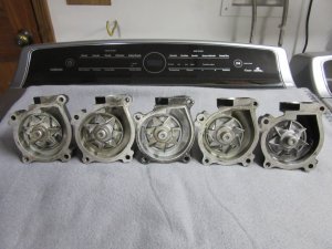

:hello: Ya, I am. :laughing7:. My German made gore tex rain jacket will keep the cone head virus at bay. :laughing7:. I have 12 OEM water pump oil seals coming on two different orders. Also four OEM cermic mechanical seals. I should see all the parts this Friday. I'll finish up the 9 pumps by this coming Sunday. IMG_9132.JPG

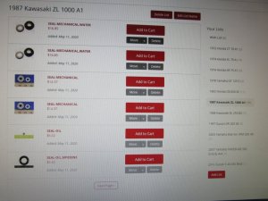

:hello: Here is a list of all the parts, part numbers and prices for all OEM parts to rebuild a ZL9/10 water pump. Total $98. IMG_9137.JPG

:hello: To the 3 members that are getting 5 pumps done. I run into a problem. Come to find out the ceramic seal is not the right size so I'm looking for another supplier.
:hello: No not yet. Since you paid me months ago I'll take the ceramic seal from an OEM 32 mm unit and use it in your pump. Give me a week or so and I'll get it to you.

:hello: Today I took all the water pumps back apart that I had done and ready for paint so I can swap out the ceramic seal with the correct one. Some time this week I'm going to All Florida Plumbing in Daytona Beach FL so I can match up the 35 mm ceramic seal.
