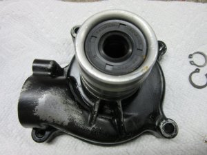

.Brad is either of you pumps leaking coolant from the weep hole if not I can rebuild them if you like. Off the top of my head OEM parts would be around $80 & labor would be $30. $14.95 for return shipping with insurance.

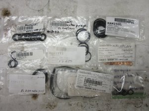

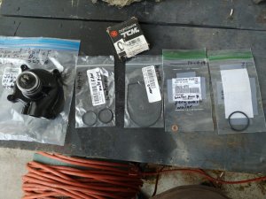

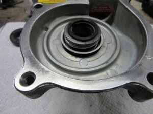

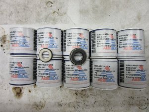

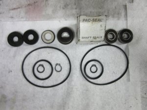

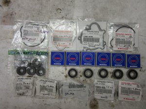

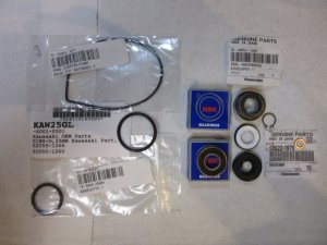

I found the 35 MM ceramic seal. I have 12 in stock a long with all the OEM parts that are needed for a complete water pump rebuild. All the OEM part #s are listed in this thread.

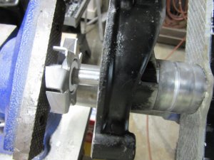

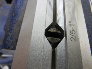

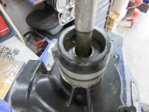

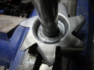

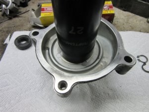

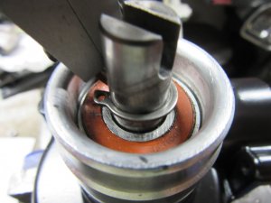

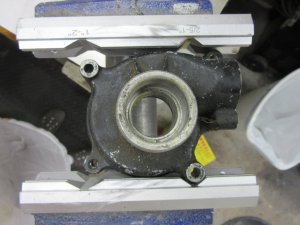

. Run your bike before doing anything. If the water pump just leaks oil. Then just replace the oil seal. Also check the propeller for play. Put the pump in a vice. Rotate the propeller with your fingers to check for tight spots. Then with both hands one on each side of the shaft & try to wiggle it side to side then up & down to check for play. This checks for bad bearing. Most of the time the bearing closest to the propeller wears out. I have all the OEM water pump part #s listed in this thread for a complete overhaul. I have 12 of each OEM part in stock. I also have the size of the oil seal listed.

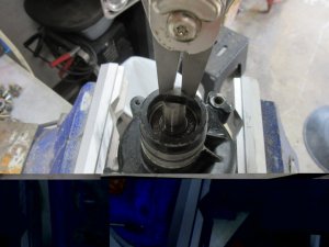

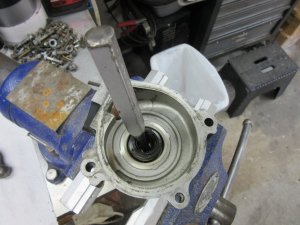

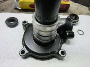

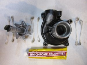

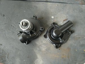

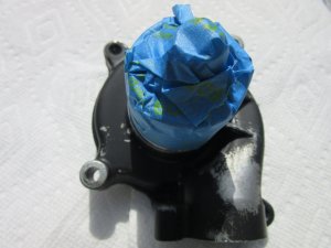

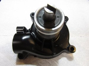

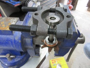

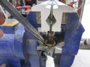

. I'm glad to help. I mailed your pump this morning. I take pics to show members that I actually rebuilt there pump.

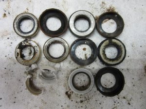

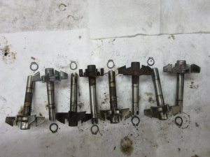

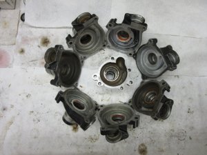

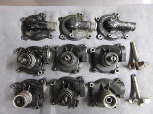

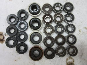

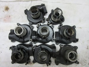

I started tearing down some water pumps today. 9 in all. Time spent 3 hours. I have 6 more but I can't find them. I can't find the OEM oil seals that I have in stock either for the ZL 9/10 pumps so I ordered 6 more oil seals from partzilla. 6 is all they had in stock. They will be here late this week.
