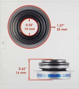

:hello: This is an update on the 35 MM ceramic machanical water pump seal. I'm still trying to find one. I ordered a few from PARTZILLA but none was the 35 MM seal. I found this one on PARTZILLA part # 49063-1001 but it is dicontinued. It seems to measure 35 MM O. D. on the cup by looking at the ruler. https://www.partzilla.com/product/kawasaki/49063-1001 . Found this one on EBAY. It states that the O. D. of the cup is 35 MM. https://www.ebay.com/itm/275661222641. _________________________________________________________________________ 20230517_110937[1].jpg 20230517_085626[1].jpg .

:hello: It would be really nice if someone else would help me find a 35 MM ceramic mechanical seal. SNAKEDOCTOR said he can get one but he is MIA like everyone else. ZL-oa to me seems like all the older members just vanished and the new members show up just for help then never comes back on the FOURM. It really upsets me!!! We can't even get TECH SUPPORT!!!
I spent so much time trying to find that seal! At one point I found it at McMaster Carr.
Try MSC industrial supply. Way back when I worked there I was able to find them in the Big book. Doubt they still have the big book but the picture with measurements above would be good to send to the sales associate you speak to.
