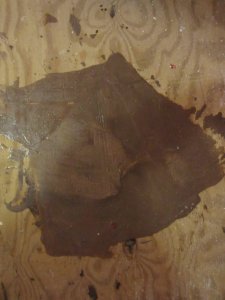

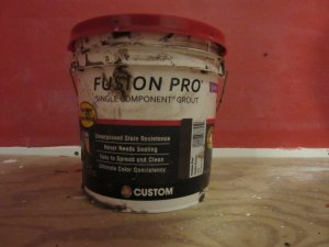

    :hello: Thanks. The acrylic grout gets hard as a rock. I tested it on a sheet of plywood the day before I used it. I'd check it every 5 minutes to see how long it took to set up. I used several tools to try to lift it and it would not budge from the plywood. No need to seal it either. IMG_8154.JPG IMG_8155.JPG

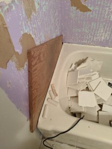

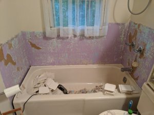

    There once was a crooked man, who lived in a crooked house... Her dad built the place so I'm just going to work with what I've got and that includes higher priorities than this.
    Budget clean up on the second bathroom, tub surround and slap down a stickum floor. Guests coming in for Thanksgiving.
    Glue in surround
    Old tile busted out, the tub is a bit crooked and not exactly where I would place it:rolleyes:
    3/4" plywood test. Off to the store for a full sheet. Plan to cut it short of the edges of the surround shim it on the outer edges and trim it out with rectangular stock flush with the surround.
    As an old friend once said, "do your best and calk the rest"

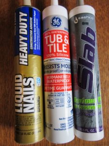

    :hello: That's a nice looking tub surround. What is it made of. I put a shower unit in our master bathroom in 1997. It has 3 or 4 cracks in it. It needs replaced. Today I finished up with the recessed shelve and the back shower wall. The vertical 24" x 16" rear section of concrete board I glued it to the back side of the dry wall with liquid nails. I filled in all the gaps in the seams with slab calk then finished with the red guard. Time spent 6 hours. IMG_8156.JPG IMG_8157.JPG IMG_8159.JPG IMG_8160.JPG IMG_8161.JPG IMG_8162.JPG IMG_8163.JPG

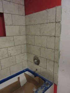

    :hello: Today I started installing the tile around the tub area. Another job I would not want to do for a living. :laughing7:. IMG_8164.JPG IMG_8165.JPG

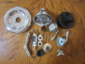

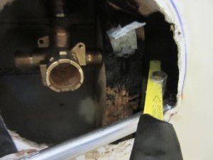

    :hello: At 6 AM today my wife scares me from a deep sleep to tell me that our master bath shower handle broke off and water was gushing out. So off to LOWES I went at 7 AM to buy a new shower unit. I bought a MOEN Caldwell model # 82495C. It was on sale for $110. I was checking the new cartridge holder unit for fitment after removing the old one and dropped it inside the wall. :banghead:. A 124 volt outlet was right on the other side of the wall so I removed it to retrieve the unit. Around Noon my friend Donnie M. who happens to be a plumber stopped by during his lunch hour. :clapping:. He says to me why in the hell are you sweating on that new cartridge holder use gator/shark bites. So Don went to his van and got some shark bites and finished up for me and charghed me nothing. :notworthy:. I get plumbing supplies from Don all the time and he never wants any money. IMG_8192.JPG IMG_8191.JPG IMG_8198.JPG IMG_8200.JPG IMG_8204.JPG IMG_8205.JPG IMG_8203.JPG

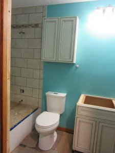

    :hello: Today I installed the toilet, cabinet, vanity light and some base board. IMG_8212.JPG

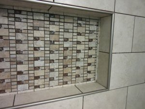

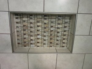

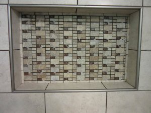

    :hello: My Wife came up with the idea to use the decorative trim in the nitch/recessed shelve. It took 4 hours. :laughing7:. IMG_8213.JPG IMG_8214.JPG IMG_8215.JPG
