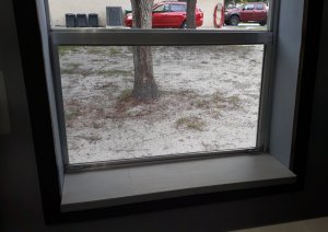

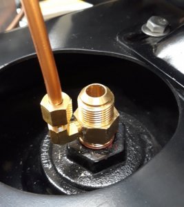

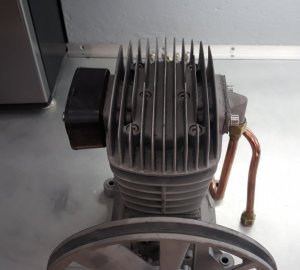

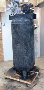

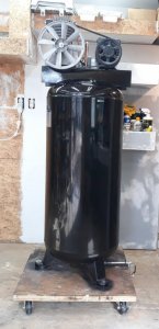

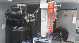

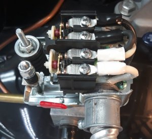

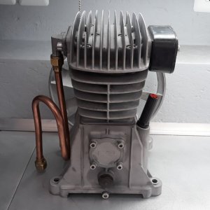

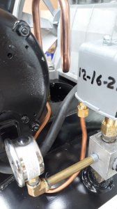

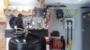

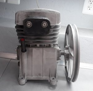

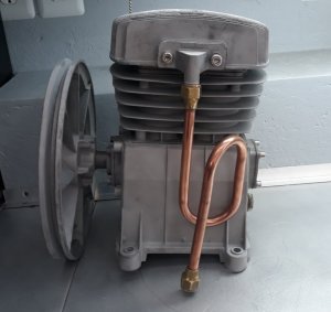

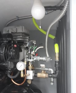

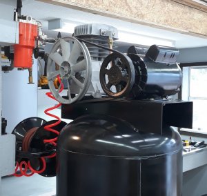

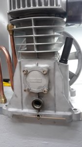

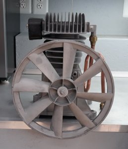

Today on the new shed for the compressor I mounted the electric motor and pump. Installed a new pressure check relief valve which goes in the top center of the tank and a new 1/4 inch air line that goes from the relief valve to the SQUARE D 240 VAC switch. Installed the new V belt. I also drained the pumps oil and cleaned the site window. Time spent for everything that I done was about three hours. https://www.amazon.com/dp/B06XHB1MBN?psc=1&ref=ppx_yo2_dt_b_product_details . A lot of guys think their compressor pump or electric motor goes bad but 90% of the time it's the pressure check relief valve that goes in the top center of the tank. It's a $25 fix and about a two hour job. _______________________________

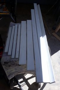

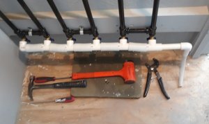

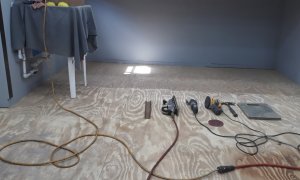

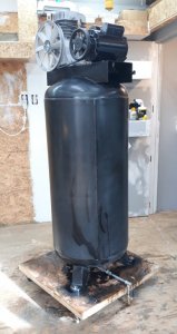

For the past 3 weeks I painted the new sheds ceiling & walls. I stated with a coat of KILLS 2 then a coat of BONDING PRIMER. Finished the ceiling in flat white. I done the walls in BATTEL SHIP GRAY. It took 3 coats. The OSB which I call SOB

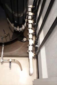

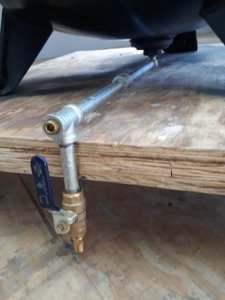

soaks up paint like a sponge. Yesterday I tied the compressors madifold systems drains into a single drain. It will run threw the floor as well as the compressors drain. I also cut & primed the base board, window and door trim. I sanded all the crud off the floor and added 3 inch exterior screws. 30% of the floors nails missed the mark.

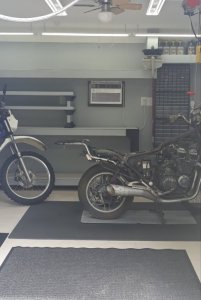

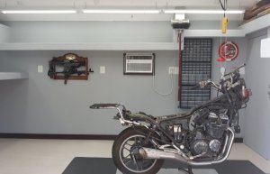

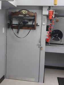

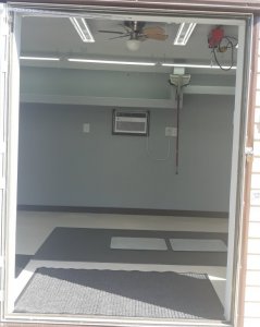

Today for my new bike shop/shed I put a 4th coat of wax on the floor. Put down shop rugs and rubber work mats. Made two metal plates for under bikes so that the rubber mats don't get tore up. Mounted my gun rack. Bolted three parts tray holders to the wall. Last I put my 1983 Honda CB 650SC Nighthawk on the hoist. It's been collecting dust for the past 12 years or so. Time spent about seven hours. ________________

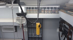

A few weeks ago I tiled all the shelves in my new work/bike shop. Time spent about four hours. I had two boxes of tile left so I said why not do it.

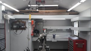

. Time to load up my new work shop with all the parts to build my 1972 HONDA CT 70 K1, 1974 HONDA XL 70 K0, 1983 HONDA CB 650 SC Nighthawk and my 1997 SUZUKI DR 200 SC. Now I need to decide which one to do first. I think I'll have all the frames done first.
