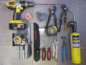

:hello: While I finished up installing my new Delta fixture ($245) in my 3 rd bathroom. I had one leak to re-solder. I started late about noon. Before installing the new cartage I purged the lines for 2 minutes. Finished up by 8 PM.

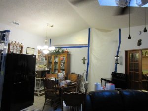

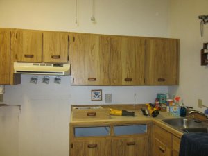

:hello: While my wife & I pulled the trigger on new kitchen cabinets. We went with the Diamond Co. out of VA. We went with all wood construction. I hate that press board crap. All's it is is saw dust glued & pressed together. We went with light oak. The cabinets was $6,280 & the quartz counter top ran $2,400. Today was demo day. My 2 son's & I took up the old ceramic tile & removed some of the old cabinets. We moved the stove, fridge, dishwasher & range to the dinning room.

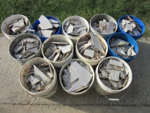

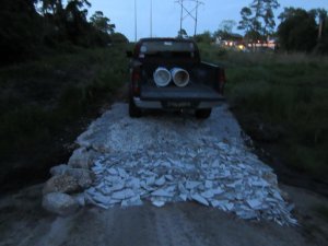

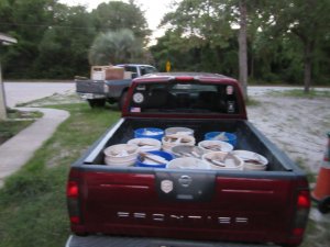

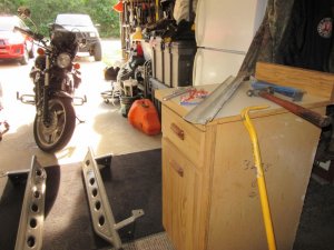

:hello: I hauled off the old tile. We have an area on the power line that is very wet & swampy. For the past 20 years or so we have been dumping concrete & other similar debris. We cover it with dirt afterwards. I'm giving my old cabinets to a friend for out in his garage.

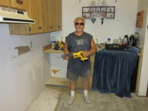

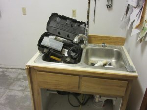

:hello: Today I pulled out the old sink & cabinet. Also I took out the dishwasher & the rest of the tile which was under the dishwasher.

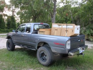

:hello: I spent most of the day going to Lows, ACE & Home Depot buying building supplies but I did add 3 more outlets & removed the upper cabinets from the wall. Then hauled them to my friend Wayne's house.

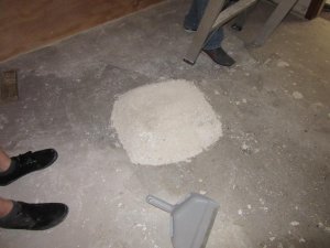

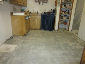

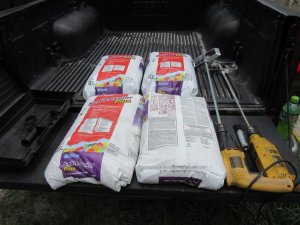

:hello: Yesterday I spent 12 hours grinding the old thinset, old grout, paint & spackling off my Kitchen floor. I filled a 3 gal. bucket with concrete dust. Today I mixed up six 50 lb bags of self leveler with the help of my friend's Wayne & Mark. First I used my 6 ft. level to locate the low spots. Then to find the low spots even better I used my garden hose to put down water. Then I traced the outside edge with a black sharpie as to wear the water met the high spots/areas. This works great. Figured this Technic out from watching the rain puddle up on the roads.

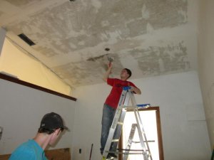

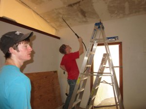

:hello: Today my Son Jared & his friend Cole removed the popcorn ceiling texture from the Kitchen's vaulted ceiling. First all the lighting fixtures was removed. Next they sprayed water on the popcorn texture using a pump up sprayer & let it sit for 10 minutes. Then spent about an hour scrapping.

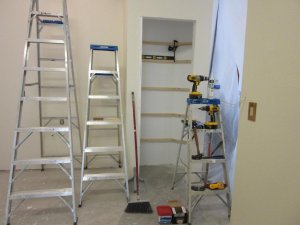

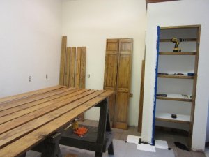

:hello: This past SAT/SUN my Wife, son Jared & I primed & painted the kitchen walls & ceiling. We also cleaned all the crap off the floor. Yesterday I installed the lighting & all the outlets. Also I tested all outlets & switches. Today I'm redoing the pantry with 7/16" plywood shelving using 2"x 2" framing. 4 of the shelves are 34"x 20" & 16" apart. Top shelve is 34"x 14" & 10" from the shelve below it.

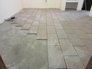

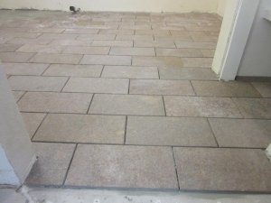

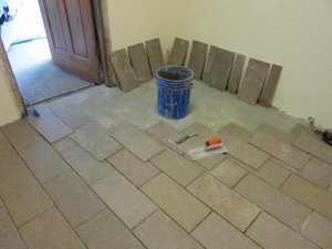

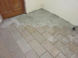

:hello: Sunday my son Jarred, wife Debbie & I laid most of the tile. We stared at 7 AM & stopped at 6 PM. Christ I feel like a concrete truck ran me over then backed up to see what he hit. :laughing7: The last time I laid tile was over 20 years ago. I do not remember it being this hard.

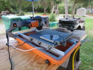

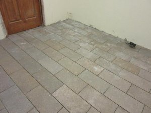

:hello: Finished laying tile today. I got a new tile saw for Fathers Day. Last week I made 2 new saw horses with shelves. Primes & painted them even though they are made with pressure treated lumber.

:hello: The Harley Brothers Wayne & Mark came over yesterday morning & helped me do the grouting. It was greatly appreciated. It would of taken twice as long by myself.

:hello: That may be true because the tile is porous & will not reflect light. I went with this brand/style of tile for it's durability & when wet you will not slip & fall. Also it is the same color all the way threw. So if it chips it won't be that noticeable.
:hello: The past few days my Wife Deb, son Jared & I cut & ripped 3/4 " pine for door frames. Then stained & urethaned them. We also did molding & base board. Stained & urethaned the new 6 panel pantry bi fold door. Hunk the bifold door. Trimmed the floor in the pantry & door frame.
